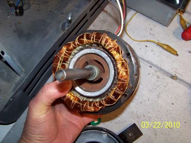

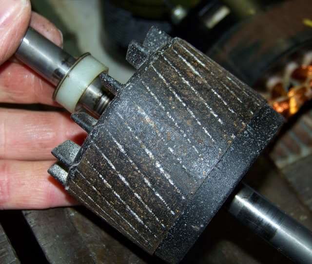

Motor now out. The odd part of this, this smaller camper lives inside my shed all winter. My bigger one lives outside as it will not fit in the shed.... The inside one corrodes up, the outside one did not??? Both are 2004 model campers. Have either of you seen this before? How do you help prevent it?
Here are the pics. Since I'm selling the smaller camper, a new motor is on the way. Be here on Wednesday I hope.

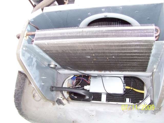

You can either unscrew the evaporator and gently move it out of the way, or go up from the bottom with a long allen wrench to remove the room air blower, leaving the blower wheel in the housing.

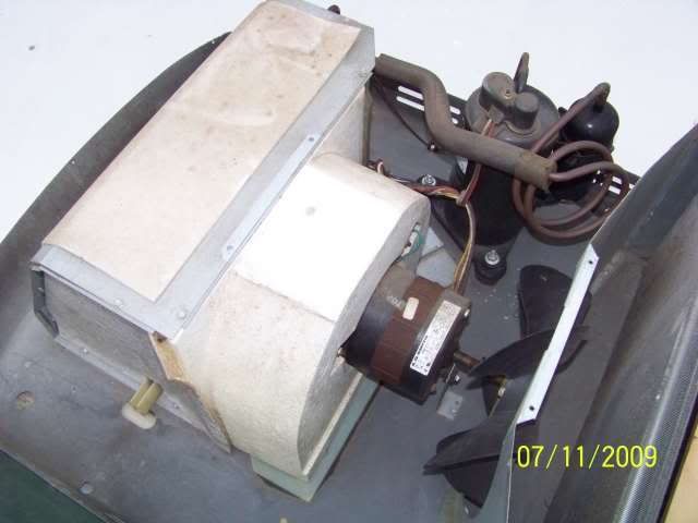

[image]
Does this mean the entire unit needs to come off the roof, flip over and take the housing off to get the fan motor out?
Or do you lift up the entire compressor, evaporator and condenser coil as a unit to get to the blower squirrel cage fan and pull it off then the motor come out?

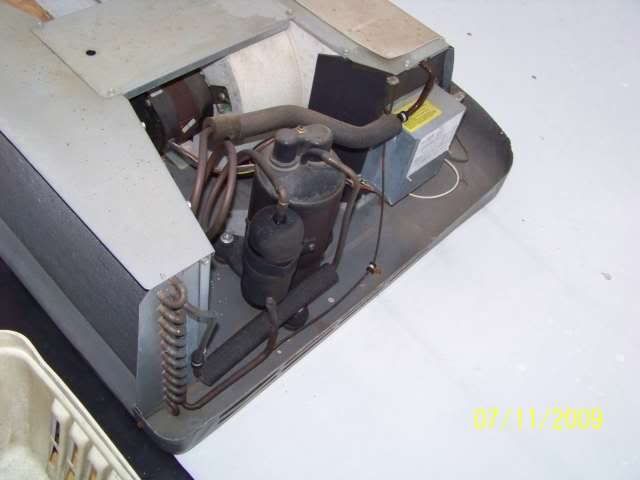

These 3 pics are off my larger camper, a 15K BTU unit verses the 13.5 unit that has the froze fan, but setup is similar.
[image]
[image]
[image]
Or is there and easier way?
What causes these fan motor to freeze up? This camper was stored inside since that last time the AC unit was uses now almost 2 years ago. My bigger camper that lives outside, no problems? Any ideas?
