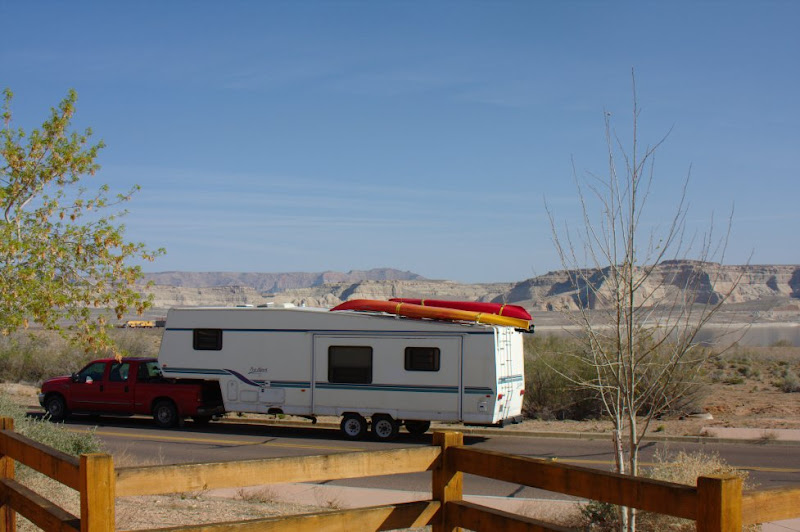

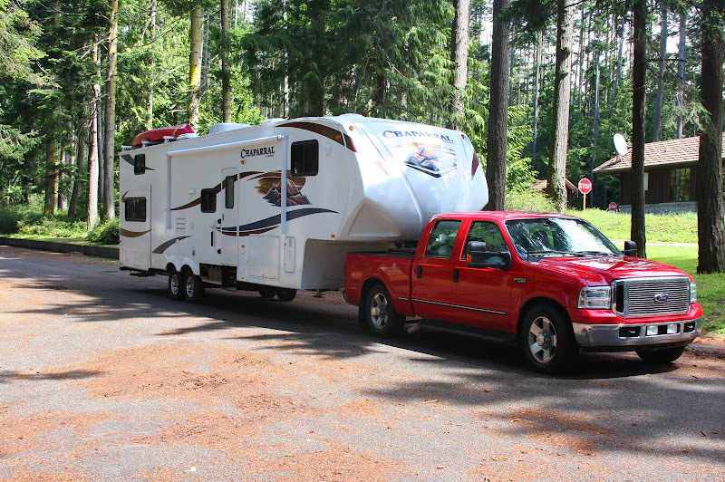

I've been pulling 32 and 35.5 foot 5ers with a Ford short box for 10 years. Never once slid the hitch back. Never had an accident. Never had a campsite I couldn't get into.
