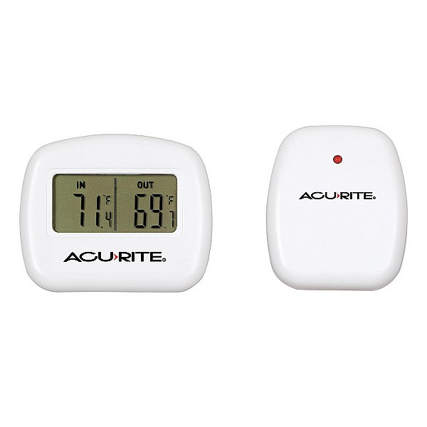

I also invested $10 in a remote temp sender/receiver to monitor camper fridge temps as we drove down the road in the car. In a 13 hour period, we rose from 32 to 42 deg F while powered by the 12v line. That was before I added the cube fan on the inside, and the PC fan on the outside. That inside fan may make a world of difference.
Acu-rite (Accurite?) thermometer:
